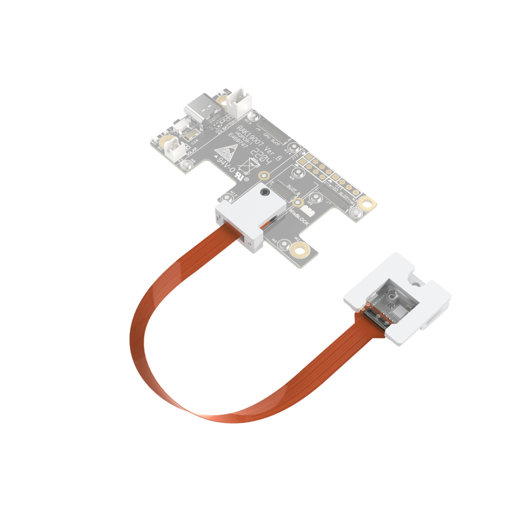

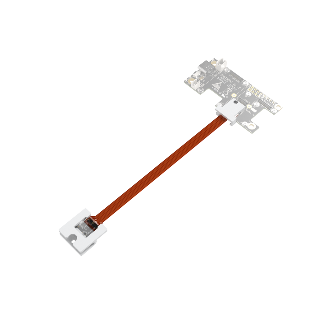

The Sensor Extension Cable for WisBlock allows compatible WisBlock sensor modules to be positioned away from the base board while still accessing all 24 sensor-slot signals. It enables developers and system integrators to position sensors for more accurate environmental measurements, rather than being limited by the main electronics' location.

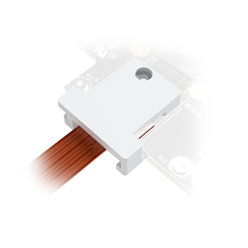

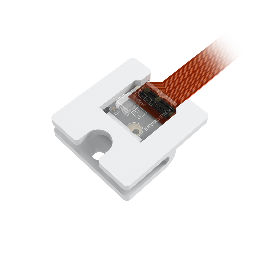

The sensor extension cable includes two dedicated mounting clips, making it a practical sensor mounting accessory for WisBlock deployments. One clip secures the extension cable to the WisBlock Base Board, while the second clip holds the sensor module using a single mounting screw. This simplifies enclosure integration and wall mounting while keeping the sensor securely positioned.

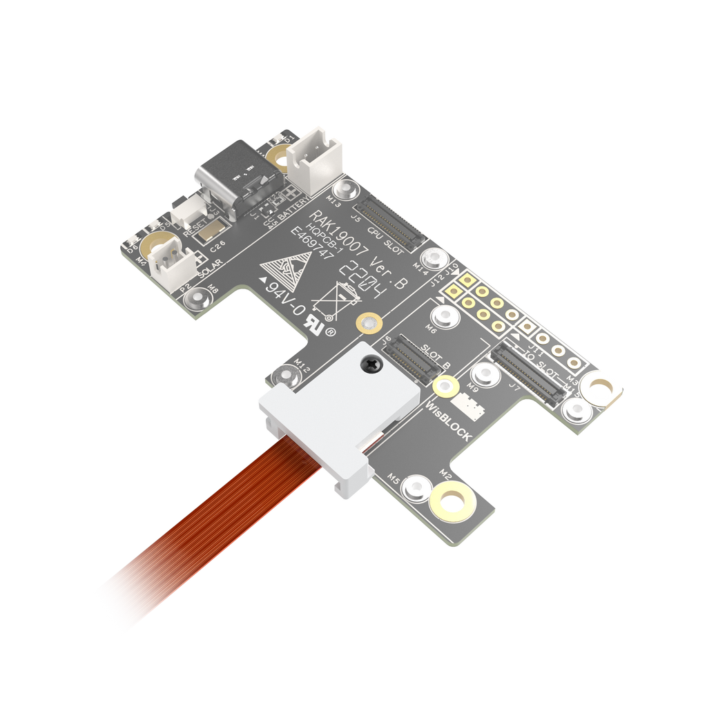

Compatible WisBlock Base Boards
The mounting clips supplied are designed for specific WisBlock Base Boards and sensor-slot locations. Verifying compatibility before installation helps ensure proper mechanical fit and secure mounting.
Base Boards
Supported Slots
RAK19007
A, C
RAK19010
A, C
RAK19001
A, C, E, F
RAK19011
A, C, E, F
The extension cable provides access to all 24 sensor-slot signals, but clip compatibility depends on the physical layout of the base board and sensor slot location.
Note:The mounting clips cannot be used with the RAK19003 and RAK19009.

The sensor cable extends the connection between a compatible WisBlock Base Board and sensor module while maintaining access to all sensor-slot signals.
Typical Installation Workflow
WisBlock Base Board
Compatible Sensor Module
Sensor Mounting Clip
Enclosure Wall / Mounting Surface
One mounting clip secures the cable connection at the base board, while the second clip secures the sensor module itself. This approach allows sensors to be positioned optimally while keeping the main electronics in the most practical location for power, communication, and maintenance.

  • 120mm length
  • All signals of the 24-pin Sensor Slots are available.
  • Easy click and use application.
  • The mounting clips work only for the Base Boards and slots listed below:
    • RAK19007/RAK19010 can only be used in Slot A/C
    • RAK19001/RAK19011 can only be used in Slot A/C/E/F
    • Cannot be used on RAK19003/RAK19009

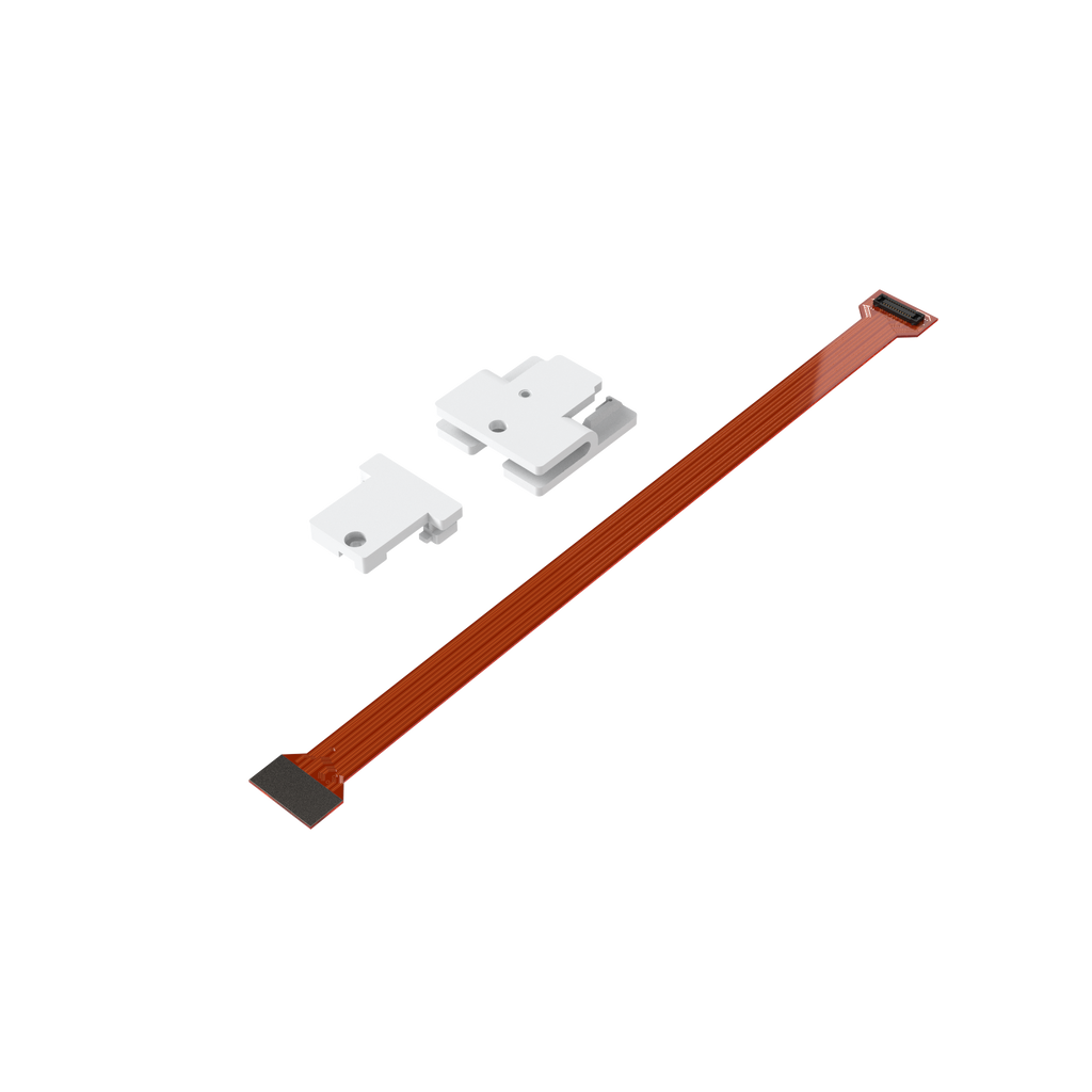

What’s in the Box
  • 1 pc RAK19005 Sensor Extension Cable
  • 1 pc Base Board clip
  • 1 pc Sensor clip
  • 1 set screw
